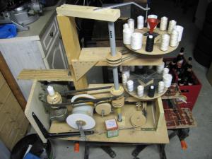

That's nice. I was thinking about of what material I would make the ''intake''. Now I kno where I can make it of. I don't need it right now because I can get enough visco from a friend, but when i'm out of resource, I know how to finish the visco-fuse-machine ;) .

But isnt it a bit fastburning?
Gr33tZ
Indeed it is, i had no other black powder on hand so i just used what was lying around. I still need to tune it down a bit so i get around 1cm/s.

Nice work PGF! It works quite good as far as I can see. Too bad you need 2 to operate it. :)
Hehe, oh well, gonna make some slight changes so it will only need one person to operate it. Firstly the funnel that feeds the powder into the first dye will be fixed to the machine in a way that it can be removed when i have to change the empty string rolls or when something else unpredictable happens :P Second, something vibrating, probably from a mobile phone, will be fixed to the funnel so you don't have to tap it constantly.
After i makes these changes it will be a one man operation . Hopefully this will be the end of construction and fuse production will begin.

Main parts used in this machine: bearings and bushings taken out of roller-skate wheels , worm gear (ratio 1/54) ripped out of Wolksvagen Golf II wipers motor.

That's a very nice machine you've got there. Spins very fast indeed. :P
You're always welcome to explain in detail how you made it. :)

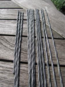

well guys, thanks for praising, I just tested my first fuse semple, results are better then I expected
check this out
Viscoburntest2-1.mp4
Speed of the mashine (RPM) can be adjusted acording your wish, since mashine used to be driven by electro drill. It has a buton you can adjust prefered RPM. Fuse -2mm thick, i didnot mesure burn speed , but on an eye it looks bit faster than standart.
As for more detail explanation Im gonna make verry clear video tutorial in one week
Take care!
P.S. wanted good advice for simple ,fast, and efective NC coating on Visco Fuse.
Share on other sites
That looks like some really nice homemade visco. The burning speed is somewhat high, but at least it burns with a constant speed.
For coating it with NC, you can lead your just produced visco through a little vessel with in acetone solved NC. Then you let it run over a couple of wheels (is it called like that?) to allow it to dry. The acetone vaporizes quite quickly, so about a 1,5 meter would be enough I think. The actual needed length for drying depends on humidity, amount of solvent used, quality of your NC etc. Please don't be stupid, and work only outside with acetone/NC mixtures, since they are extremely flammable.
