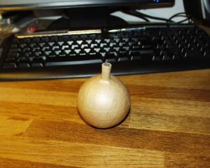

I Think I have some pictures
Well if you look at the pictures (they apply for all my shells, let them be small or large) the stars are aranged by the walls (pumped stars work really good as they stack nicely) and then break charge (very fast granulated BP or BP covered rice hulls) is put in the centre of the shell (on smaller shells I use a booster like whistle or flash, or you could just use H3). The shell is closed and spiked with hemp twine (2mm type), and pasted with a long strip of paper wich has been pasted heavily with WHEAT PASTE (this is important, wheat paste, when dry, is brittle and not flexible, this provides a better break)
This is basicaly it, the key is wheat paste (in my opinion) and a good spiking job. The break does not play a very important role, you could break the shell with poor BP if the spiking is good.
Deadman, I have attached a piccy before they were fired (although the pic is not from the construction, they are finished with fuse and everything). The ring shell was the little one (50mm)

Yellowcard, I secure the fuse with hot melt glue (strong and water-proof), the additional strenght comes from the pasting when I fold the excess paper around the fuse creating a crown.
The 75mm shells weighed around 180-190g, so I used around 16g of BP to lift them.
