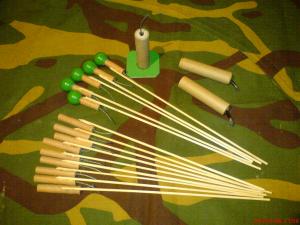

Hello guys
Here you can see the latest production of goodies. As you can see, the leading idea was that widely spread „small is beautiful“ one but if you carefully check the image, you should be able to spot two crackers of enormous size...well, I was carried away somehow. In fact, it was a specific order from my friends son, I had to keep to his specifications. Those small slim lined rockets are stuffed with small sip of flash powder and inevitably explode at apogee while those having green ball header are filled with BP chunks with crackle bits. Nothing spectacular but kids should love it. Unfortunately only one fountain was made due to lack of time...ehm, I know this is not an excuse but I had to say something in my weak defence. Here comes the image....

Hey Blaf,
Nice devices you've got there, thanks for taking the effort to post them in here!
Even though your post back in march remained un-replyed to.
May I ask you what kind of fuse you are using there? The kind your using for the rockets looks formiliar but the ones on the customized "1/4 sticks" you made appear exotic to me.

Hello Amateur
Nice Username, hope it doesn't imply your ignorance in the field, he, he. As for the fuse I'm using on rockets, it's my own make (you should check Visco Fuse Machine topic which I started almost 2 years ago) while the one seen on big crackers is commercial type – they call it Bickford type fuse. If I had used the thiner domestic type it wouldn't have looked nice on these big brutes! By the way, their dimensions are L=12cm, diameter is 3cm. Here comes the image...
Anyhow, thanks for your feedback...and if you have any questions, just go ahead!
