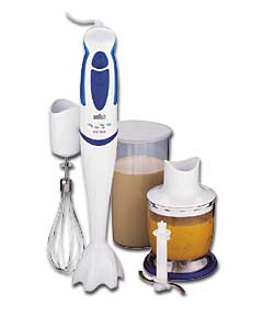

Julicher showed me some foto's of a visco machine which looked a lot like my computer drawings and I saw how the drive was done. And it looked perfect, I'd have to adjust my own drawings a bit but it should work, but I still need an engine but my dad gave me an idea:
You have these sets with kitchen things (blenders and stuff) which you can click to 1 thing with an electromotor in it, and that solved 2 problems, I wouldn't need more electromotors, and I could get the electromotor by just buying a cheap kitchen thing set, they're strong and you can put them on the powernetwork.

Hello RSDZ
I wouldn't know exactly what the kitchen blender looks like inside and what kind of a motor it uses but generally, all those small electric appliances use small AC motors of rather high RPM. The final rotation of the tool is regulated by simple cog-wheel gearing made of plastic like in mixers. Other ones like coffee grinders and juice makers take advantage of a high RPM and tool is attached directly to the motor shaft.
If you ask me, I would opt for DC motor and regulated power supply so that you can play with speed at will.
But then, it's only my humble opinion...

That makes a HUGE fibration. Or ripping apart a old xbox controller, they have 2, 1 big one small for vibration. Then instead of sticking the funnel into the wood, suspend it in rubber, and stick a vibrating device on it. That would probly help.
Do you mean like in this picture?:
I didn't really understand that picture, that rubber thing, but it's just like a small bendable tube if I got it right?
